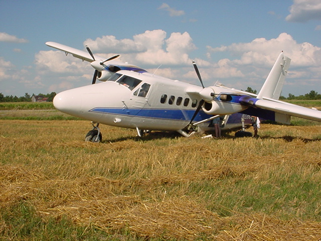

rapper4mpi 0 #1 September 5, 2002 This quote appeared in a weekly DZ newsletter: "So... there I was, beautiful Saturday, getting all geared up for my fourth jump, and someone runs into the hangar yelling "HOLY S**T!!!!! Frankenotter just groud looped!!!" Picture below... The landing gear snapped on the left side on landing. All is fine, though. It should be repaired and flying back to CSS today. More importantly, noone got hurt. Mario is an AWESOME pilot for saving it from more extensive damage.... Anyway, thought I would pass this along since I hadn't seen it anywhere. -Rap Quote Share this post Link to post Share on other sites
Marz 0 #2 September 5, 2002 That was my quote, and I posted it on here on monday or something... anyhow, here's the pic if you missed it... Damage was minimal, thanks to Mario the pilot. _________________________________________ Did I just kill another thread? Quote Share this post Link to post Share on other sites

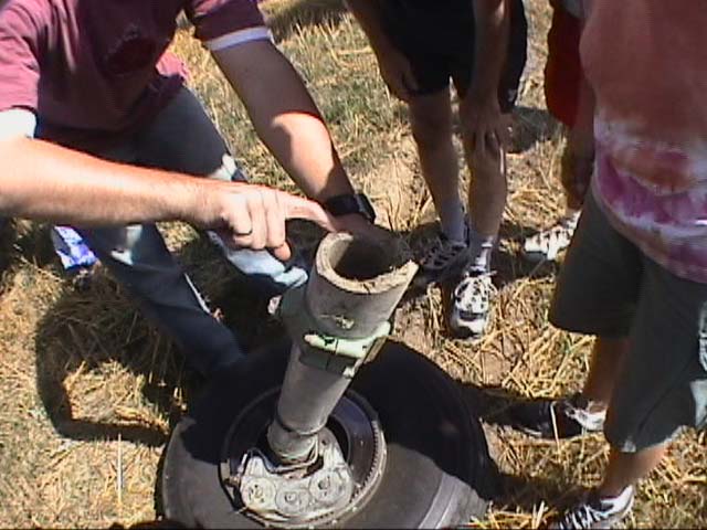

Marz 0 #4 September 5, 2002 well, driver, i'm no expert, nor am I a pilot, but what the machanic told me in passing is that there was a crack under a weld that "couldn't have been seen". When I went to check it out, it didn't look like it just "decided" to snap off... there looked like the was rust run-off near the break... That's about all I know. Like I said, I'm no expert...I attached a pic of the gear, this may illuminate someone with a little more knowledge... _________________________________________ Did I just kill another thread? Quote Share this post Link to post Share on other sites
diverdriver 7 #5 September 5, 2002 Rust? I wonder if they've ever heard of a 100 hour inspection? Cracks don't appear over night. Thanks for the photo.Chris Schindler www.diverdriver.com ATP/D-19012 FB #4125 Quote Share this post Link to post Share on other sites

kallend 2,196 #23 September 5, 2002 Quotewell, driver, i'm no expert, nor am I a pilot, but what the machanic told me in passing is that there was a crack under a weld that "couldn't have been seen". When I went to check it out, it didn't look like it just "decided" to snap off... there looked like the was rust run-off near the break... That's about all I know. Like I said, I'm no expert...I attached a pic of the gear, this may illuminate someone with a little more knowledge... As it happens, I am an expert (Ph.D. in metallurgy/materials engineering, extensive experience in failure analysis). Unfortunately your picture is not clear enough to draw a conclusion. If you could get a close-up of the fracture surface and the "rust" stains, it might be possible to figure out why it happened. BTW - fatigue cracks can be invisible to the naked eye up until the point that the component breaks, don't expect a 100 hour or annual necessarily to pick them up. That is why ultrasound/X-ray/eddy current/dye-penetrant tests were developed. Quote Share this post Link to post Share on other sites

diverdriver 7 #25 September 5, 2002 Right, and when you have a hard landing the pilot is to ask for a gear inspection so that die penetrant can be used. Chris Schindler Quote Share this post Link to post Share on other sites
