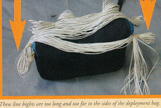

Luna 0 #1 January 24, 2003 Okay, I don't know if I should really admit to this or not, but if you look on page 35 of the new Parachutist, the 2nd picture from the top is a pic of my first pack job. I think Jim made a couple of minor tweaks to make it look worse, but believe me he didn't have to do much. So, any advice for me? I guess that's why you should practice a lot before actually jumping one (which I still haven't done yet, stupid ZP! ) I'm walking a marathon to raise money for the Leukemia & Lymphoma Society. Click Here for more information! Quote Share this post Link to post Share on other sites

Luna 0 #7 January 25, 2003 Quote LOL... Now i cant wait to get mine... Yeah, I bet! Well, since many of you seem to be postally challenged (I got mine Thursday, what's up?), I used Lolie's prompting to finally get me to install my new scanner (old one bit the dust a while back). So, here it is, in all it's glory (keep in mind, this comes from an article about how to prevent hard openings!): I'm walking a marathon to raise money for the Leukemia & Lymphoma Society. Click Here for more information! Quote Share this post Link to post Share on other sites
indyz 1 #8 January 25, 2003 It would've opened. I'm terrible at making neat stows, so I've jumped stuff that looks like that a few times. Quote Share this post Link to post Share on other sites
wmw999 2,628 #9 January 25, 2003 Quote a pic of my first pack job. [Blush] I think Jim made a couple of minor tweaks to make it look worse, but believe me he didn't have to do much. So, any advice for me? Yes. First pack job, probably the first thing you've had in Parachutist -- I'd say it calls for a case of beer!I had to say it. But practice will help a lot. It doesn't look like you did, but one thing you don't want to do is milk the lines; i.e. run your hands along them to get the stows looking really nice. Then you end up with spaghetti at the risers. Much better to have each stow just a teensy bit uneven than a whole lot of uneven at the end. Wendy W,There is nothing more dangerous than breaking a basic safety rule and getting away with it. It removes fear of the consequences and builds false confidence. (tbrown) Quote Share this post Link to post Share on other sites
