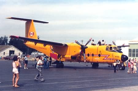

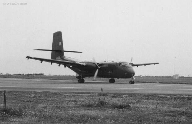

PhreeZone 20 #22 September 21, 2002 >DHC-5 Buffalo. You'd have to wear all black to avoid staining everything with the oil that thing leaks/burns/etc Yesterday is history And tomorrow is a mystery Parachutemanuals.com Quote Share this post Link to post Share on other sites
diverdriver 7 #23 September 21, 2002 Ummm.....it's a turbine engine aircraft. If it's using oil then you're going down in flames Phree. You might be thinking of the Caribou? DHC-4? Chris Quote Share this post Link to post Share on other sites
PhreeZone 20 #24 September 21, 2002 That is.... Opps Here is a DHC-4Caribou Here is a DHC-5/CC-115 BuffaloYesterday is history And tomorrow is a mystery Parachutemanuals.com Quote Share this post Link to post Share on other sites
