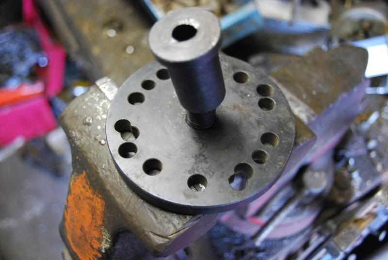

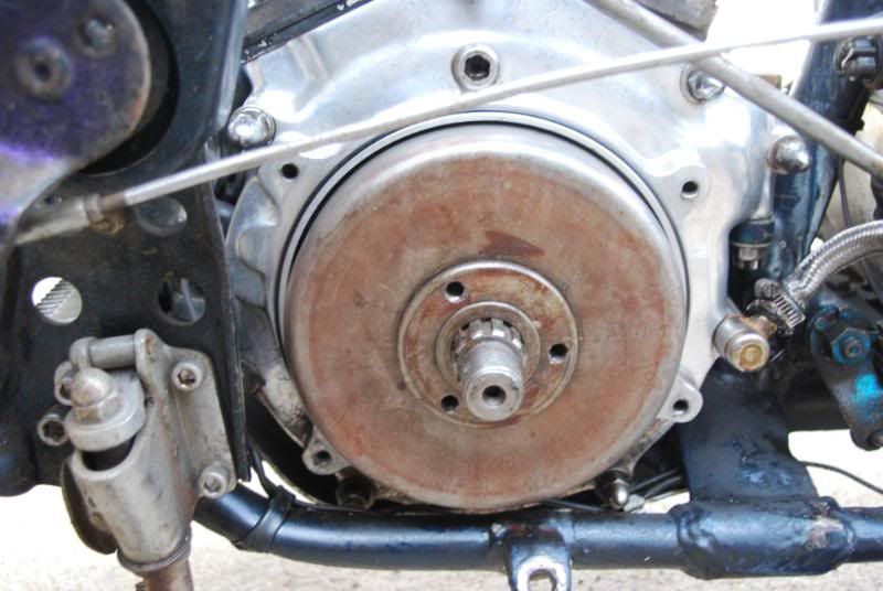

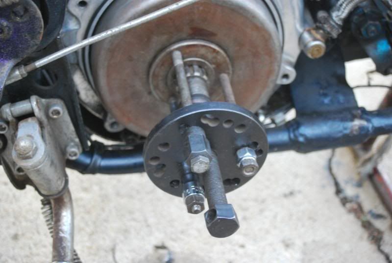

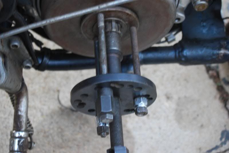

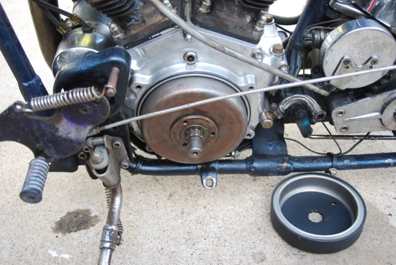

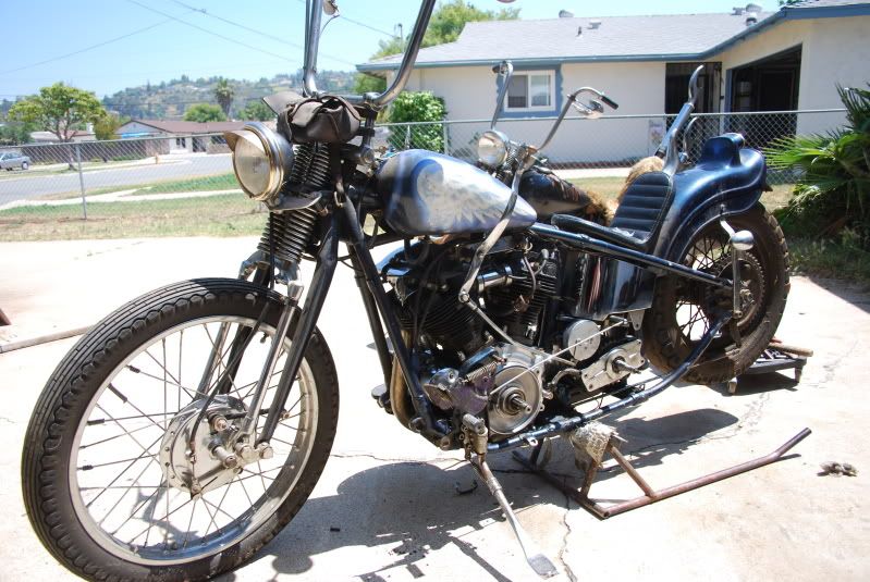

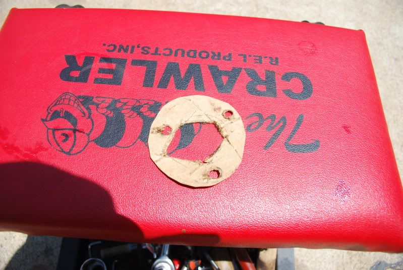

skyrider 0 #777 June 3, 2010 My morning,Spent working on my wifes Knuckle...it is a Altinator /Genorator motor I built back in the 80's from parts I had laying around... It is actually a 1974 left case mated to a 1947 right case..No numbers, and perfectly legal! The generator houses her ignition coil....the electrics run off the altinator...only took a touch of machining to make it work! Anyway , my Problem is I need "this" to come off... http://img.photobucket.com/albums/v400/onekick/American%20Dead/018.jpg But I Don't have a puller (I swear I did have, but can;t find it) http://img.photobucket.com/albums/v400/onekick/American%20Dead/019.jpg So....out comes the cardboard...trace the holes... http://img.photobucket.com/albums/v400/onekick/American%20Dead/027-1.jpg Add a drill press, and turn this....(clutch hub puller) http://img.photobucket.com/albums/v400/onekick/American%20Dead/021.jpg Into this Plus 3 case bolts, and Walla ,(veola?) turned into a rotor puller..... http://img.photobucket.com/albums/v400/onekick/American%20Dead/023.jpg OK, a few off the wall spacers too! (Nuts, sockets, washers) http://img.photobucket.com/albums/v400/onekick/American%20Dead/024.jpg Quote Share this post Link to post Share on other sites

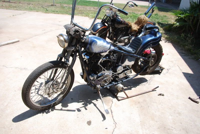

skyrider 0 #778 June 3, 2010 The bike I am working on, My wifes 47 http://img.photobucket.com/albums/v400/onekick/American%20Dead/028.jpg My 42 is hiding behind it, it is next on the chopping block, it has to coem completely apart so I can weld the frame! http://img.photobucket.com/albums/v400/onekick/American%20Dead/029.jpg Quote Share this post Link to post Share on other sites
NickDG 23 #779 June 3, 2010 On my Evo that cover houses the alternator so you can pull it off with your hands. I had Gennie Shovel back in the day and they are sometimes a PITA. Those generators could, and would, go bad just sitting on a shelf . . . NickD Quote Share this post Link to post Share on other sites
skyrider 0 #780 June 3, 2010 Quote On my Evo that cover houses the alternator so you can pull it off with your hands. I had Gennie Shovel back in the day and they are sometimes a PITA. Those generators could, and would, go bad just sitting on a shelf . . . NickD The new replacement I bought, (laying on the ground) won;t likely ever need a puller, BUT , it has me nervous, seems like a lot of wieght spinning on sooo little metal, the old oen had a 1/4 of shaft connecting,the new one, less than a 16nth..... Quote Share this post Link to post Share on other sites
skyrider 0 #781 June 3, 2010 looks like we do have the same tool scooter/tray! Quote Share this post Link to post Share on other sites
